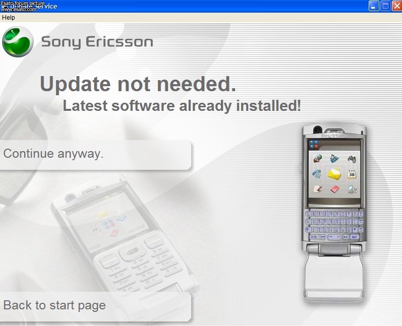

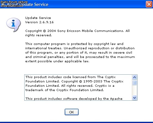

antz88c Joined: Aug 10, 2006 Posts: 297 PM |
SEUS is 2.6.9.16
But NO UPDATE
snowbren Joined: Apr 25, 2006 Posts: 20 PM |
Thanks for posting the pictures. So the SEUS updates itself automatically...but looks like we will have to wait for another ROM upgrade. I e-mailed Agile Mobile regarding the Messenger conking out after trying to access the menus. Maybe they will release a new version.

Guy H Joined: Feb 19, 2004 Posts: > 500 From: UK PM |
Got mine on Voda but told it's a Vanila handset (ish got voda startup and settings in but can edit them)
Phone: R5A006
BT: R4F01
Org: R3A04
CDA:R2A04 (this is repeated twice for some reason?)
SEUS says it's up to date. |
