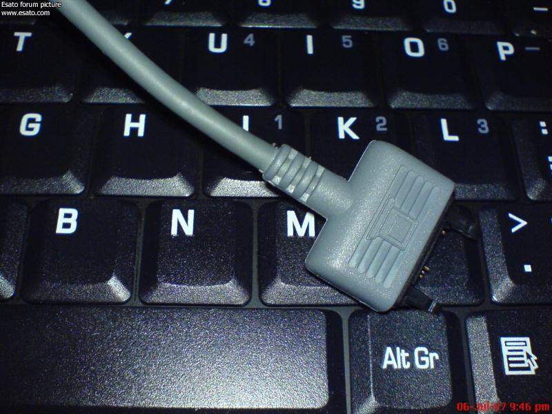

On 2007-07-06 20:43:30, amarsidhu wrote:
@lpachuong: i clicked this pic with your driver, led was on and it came like this. focus is ok but i think there is some prob with the led sync.
have a look.
is LED flash working ok in your phone
I am using K750i CID49 RED, Camera from old K750 CID 36
You can find almost all the camdrivers here
BBCode End -->
[ This Message was edited by: amarsidhu on 2007-07-06 19:45 ]

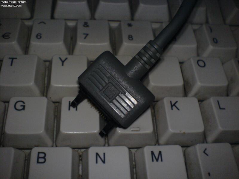

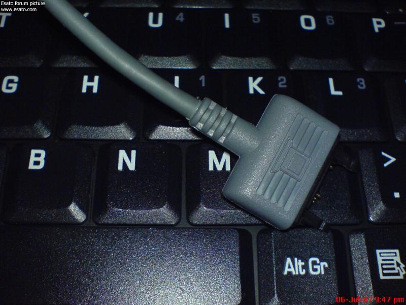

Hi!!! The led works well on my fone. I think it is bcz of the angle of the incident light from the led is not suitable. Please try with some other place at night.
These two pictures are taken from my driver. CID49. Different angle, different effect. What do you think about these?
Thank you for having a look at my driver. If you cant get clear/detailed pictures at night with flash+nm, reduced EV to -0.7 -> -1.7.
Cheer.

On 2007-07-06 19:31:24, amarsidhu wrote:
Today i clicked some more pics with SPU beta 9 & SARMAD's 5.7
Sarmar's 5.7 Pic
SPU Beta9
Picture were coming so colorful I though why not stand beside the tree.
Pictures are original without any enhancements.
Now according to your views, which one is better.
I have tested the SPU 1.3 beta 9 driver with MXE-60 flash and the results have been very bad. All the pics were very dark because there wasn't synchronization between the flash and the moment to take the picture.
