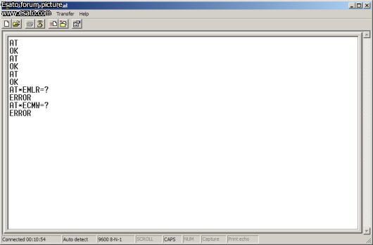

I'll have a go, I've got the BT serial connection and Hyperterminal...

mwright
Joined: Jun 21, 2003
Posted: 2004-07-15 23:38
OK
You need to find the port that "serial port 1" uses from the BT dongle to the phone and then setup HyperTerm to use that port directly. Set it to something like 9600 baud.
If it works, sending "AT" should get back "OK"
If you get that far - try the following and save the output
at*emlr=? Should get back OK
at*ecmw=? Should get back something like *ECMW: (1-15) then ok
Did you follow that ok?

GazB
Joined: Jul 16, 2004
Posted: 2004-07-16 21:26
@ mwright, i gave this a go using my BT connection this is what happened.
seems to be connected but the commands dont work, any thoughts
Gaz
mwright
Posted: 2004-07-16 21:36
Yep - it looks like someone (either SE or Orange) has blocked the AT commands as well!!
Is there anyone here with a non-orange K700 care to try it. It does no harm, the commands are only checking that the commands are supported. They work fine on T68 and T610
