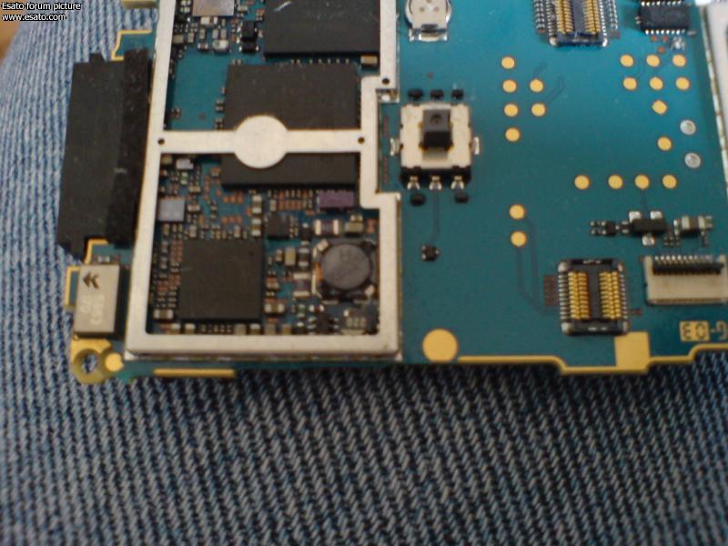

Just found the probable culprit to the phone refusing to power up:
See the circular chip in the foreground? That has a crack the size of the San Andreas Fault in it! Bugger.
Phone is now on Ebay anyway, along with a faulty W810i that isn't part of the experiment if anyone's interested!

Im failry sure that that chip in the picture is fine, from experience ive seen others like it , and they are supposed to have a little copper showing. At least I think the do. As for k800i silver power buttons, you don't get them, the ones i have seen/used all had black ones...

Though there is a large diagonal crack on that chip which isn't too obvious from the picture which doesn't look normal - if that isn't a problem then someone will get a bargain!

That cracked chip would be very hard to replace, it would need I imagine some very presice and fine soldering to get the old one out, and to fit the new one. I'm not sure where you'd get a replacement chip anyway, unless it was out of another phone.
