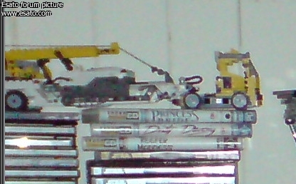

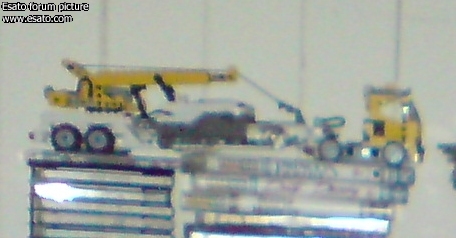

Increased my buffer to 1MB, compression to 95%
This is a crop of a 90% picture (stock Driver):
This is a crop of a picture using 95% driver:
Now, at first glance the 95% driver seems a lot clearer, and this is exactly what I am hoping less compression can achieve. But before we get excited, I'd like to do more testing to ensure this result is easily repeatable.

I've got a 98% driver in at the moment, with only 1MB buffer, it seems to be working okay. But I have yet to take a lot of photos with it.

yes but fon't get too excited. I did a few pics and it seems to be true, but I haven't done enough comparisons to eliminate poor focus etc.
Looks promising, but more comparisons needed. Also, as mongoose says, driver may be unstable.
