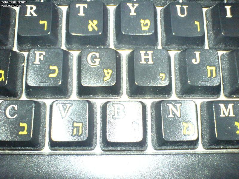

Posted: 2007-07-03 21:20
Raiderski, I have a problem with your latest driver:
Everything is amazing, except over-flash effect:

Mad_Wedgie
yes... i was undecided how to use led light and i decided to leave "more light" variant. overbrightness help in very dark situations, on other side it will overbright anything else but i think more light is better than not enought light. simplest solution to handle big/low brightness is to change exposure time to low value. if i will find better settings for led then i will use them.
