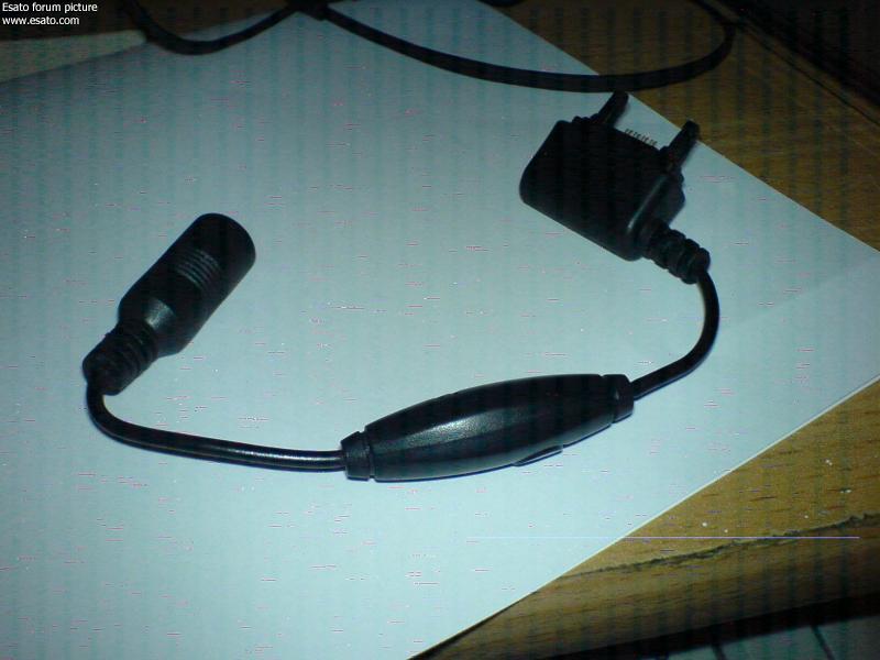

Er since i upgraded my phone to R1AA008 my pictures are coming out funny. This one was taken 2mins ago.
If you want to see pictures when i was on R1N035 look at http://www.esato.com/board/viewtopic.php?topic=111391
I reckon its a bug, can anyone else check your pictures from your phone?

I have no problems with pictures after upgrade to R1AA008
In fact they seem to be slightly improved under certain conditions, and I think I know why.
I just noticed, more or less by accident by looking at exif data, that R1AA008 now uses Center Weighted Average metering instead of just Average metering as used on previous firmwares. Its a development of average metering and an improved way of metering the light as compared to just average metering.
Standard Average metering measure the lighting in the whole of the image sensor’s area. Then finds an average of all the light, which hits the image sensor and then calculates the exposure from this.
Center Weighted Average metering basically does the same, but with more emphasis on the area in the center of the image where the object you want to photograph is usually located and usually more lit than the surrounding. This gives a better more precise exposure balance between the object and the surroundings. It increases the quality of the centered lit object, and at the same time decrease the level of noise in the darker surroundings.
