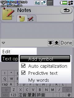

whats the triangle thing supposed to do or be for when you open the screen keyboard??
you know the thing on the right it appears when im writing and stuff
mine is a black one
whats it for
thanks
Ben0667,
On different version of UIQ3, when you press that little triangle, different menu will scroll down.
Mine looks like this:
I guess it looks different from yours.

no i have that but i also have another big black triangle that sometimes sticks out the right hand side of the screen and when i click it nothing happens i dont see the point of it

Thats for when you are typing, if you write abovethe arrow it is for Numbers 0-9 when in line it is for CAPITAL letters and below is for lower case
