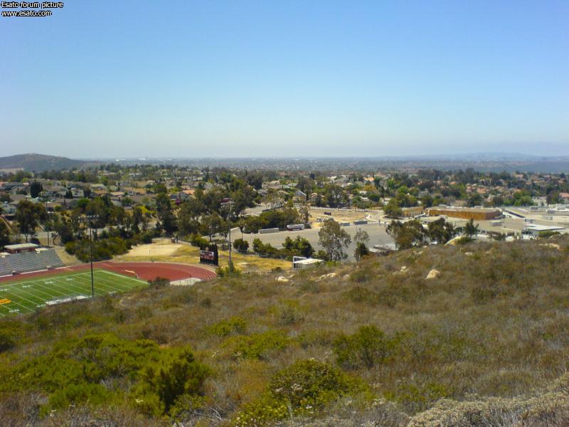

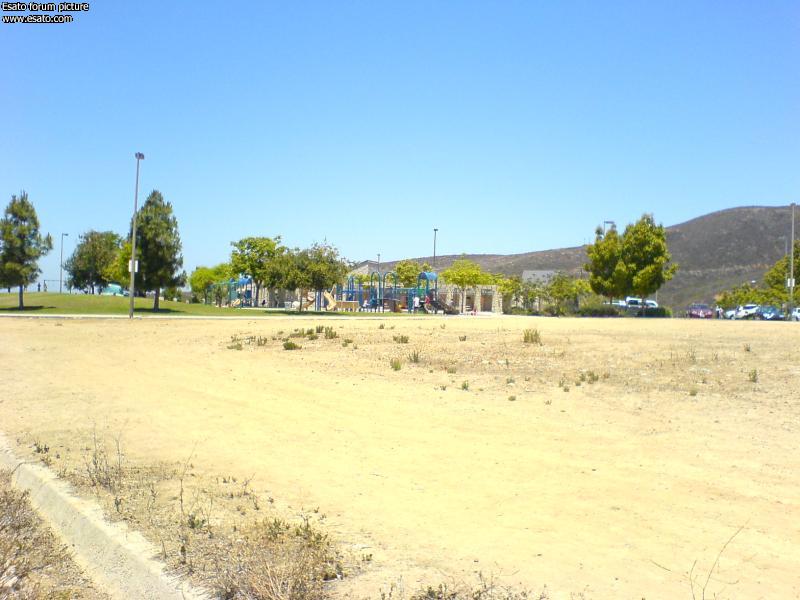

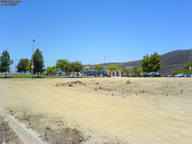

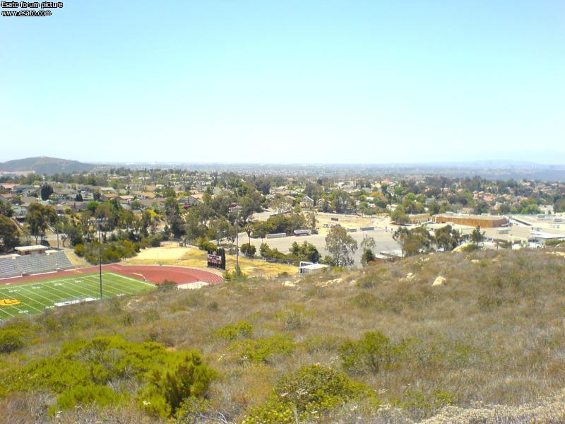

all with SPU's 1.3beta4 with CC fix. focus infinity on all shots. EV manually set really low on all shots
manual exposure 1/2500s, iso 80
manual exposure 1/1250s, iso 80. sky is over exposed but notice roof tops and trees in the distance appear sharper
manual exposure 1/1600s, iso 80. sky a bit over exposed, everything else much sharper. this is EM at work
testing SPU's complex scene theory. manual exposure 1/5000s, iso 80, filesize 585 kb
again testing SPU's complex scene theory but with higher exposure. manual exposure 1/1000s, iso 80, filesize 649 kb!

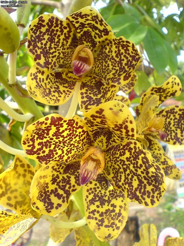

oh, i forgot to post picture
here:
it special flower named Anggrek Macan from my province
800i CID36 R1BC002
810i CID49 R4EK001 R3A005
