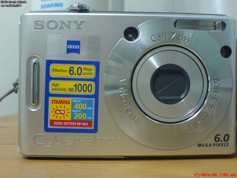

v7.8 raw data last night through the glass
http://img155.imageshack.us/img155/6824/dsc05877pn0.jpg

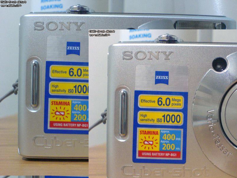

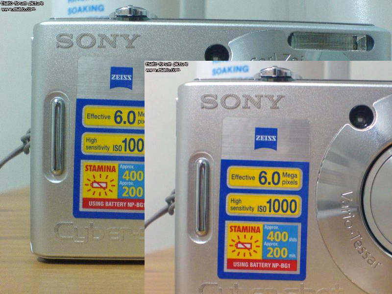

diego23 Joined: Aug 27, 2006 Posts: 32 PM |
v30.1 by e_erzan v7.8 by imsje v30.1 by e_erzan v7.8 by imsje |
biasiman Joined: Mar 27, 2006 Posts: 80 PM |
from the above comparison I see 7.8 definitely more yellowish and 30.1 more blueish. It is up to whoever took the pic to say which one is closer to the tue colors...
[ This Message was edited by: biasiman on 2006-11-04 18:46 ] |
imsje Joined: Sep 07, 2006 Posts: 76 From: Croatia, Dalmatia PM |
On 2006-11-04 19:11:39, diego23 wrote:
7.8 is little bit sharper.
I think color is diff. because of this.
30.1
seq_set_prop_0=$s0 %0 $-0 0a 06 02 00 01 $w0 06 #CMD_END;
seq_get_prop_0 = $s1 1e $s0 01;
7.8
seq_set_prop_0=$s0 %0 $-0 0A 06 02 00 01 $w0 06 #CMD_END;
seq_get_prop_0 = $s1 07 $s0 07;
which one is more natural. which light you used?
Ya a bit sharper on the second... a little hand-shacking? |

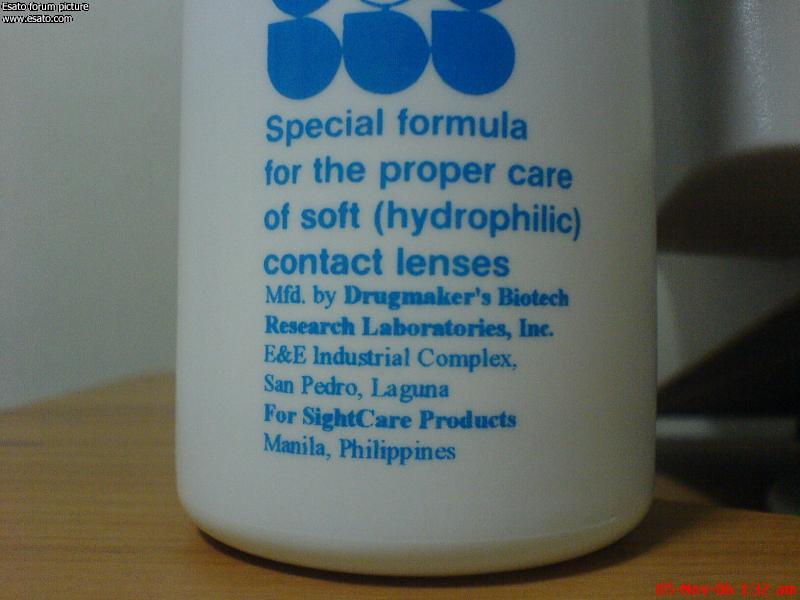

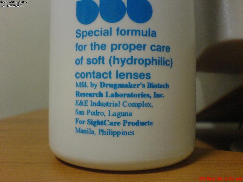

Mark_Q Joined: May 01, 2005 Posts: 138 From: Helsinki, Finland PM |
biasiman,
It's quite easy to put the original agains color corrected copy to see the color cast:
v7.8:
v30.1:
