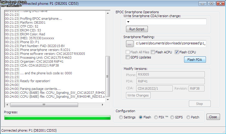

ripclaw2002 Joined: Dec 08, 2007 Posts: 15 PM |
all
i used XS++ on my W960 and now i have 2 lines :
CXC 162037 R9H004
R9J005
prgCXC162037_CCPU_HE_LL_NI
Organiser :
CXC162146 R6E31
CXC162146 R6F41
CDA:
CDA 162032/1 R6E29
CDA 162032/2 R6F40
when i used seus to upgrade firmware, it tells me nothing to upgrade and my firmware is the latest. help! |
there's no option to click next. there's only back to start. can anyone offer any more advice ?
thanks a lot! |

My phone would stay black and only the keypad would light up so
I flashed the P1i resurrection package but it always failed on the 8th flashblock and after that the GDFS could not be read and any program refuses to identify the phone (SEUS, kulankendi, davinci, XS++). Before that, the GDFS was recognised.
Any help please?
I do have a GDFS backup but XS++ will just stay there when attempting to restore.
From davinci:
Error! Failed To Start GDFS From ID Loader! Code: 0x04
Warning! SW , Lang, CDA Will Not Be Detected!
Error! Failed To Read GDFS 0x02 0x06D4! Code: 0x0C
Error! Failed To Read GDFS 0x02 0x079E! Code: 0x0C
Model info:
PDA software version:
Unknown Unknown
Phone software version:
Unknown Unknown
Bluetooth software version:
Unavailable
CDA version:
Unknown Unknown
[ This Message was edited by: qwerty12 on 2007-12-17 16:28 ] |
