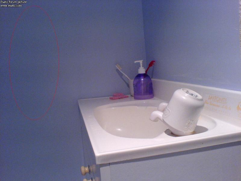

@ Raider: When you take a shot at uniform colors say a wall it has faint horizontal scan lines like when you try to take a shot of a CRT monitor, I think this is caused by the slow down of the viewfinder?
heres a pic
I circled the most obvious area but its in the entire pic...
maybe you can add the variable to speed or slow down the viewfinder?
actually it shows up whenever you take a pic in poor lighting you can see the scanlines...

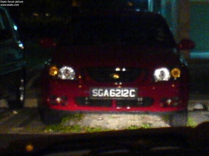

Posted: 2007-06-11 18:12
taken by sarmad 5.7w810i
its nothing big however my dad questioned can i take the carplate of the car infront at night
so i tot no i cant
den i did the digital zoom x4 in nightmode and it was so sharp in the phone n sharp too in the camera how excllent

i found similar effect in my bathroom. now better sit down because explanation is laughter worth electric current frequency has 60Hz (in some countries 50Hz). so, if you light up this room with fluorescent lamp then it works with that frequency, which means: the lamp emits the light 50/60 times per second. camera sensor works with 50Hz/60Hz frequency, CRT monitor also draw image on selected frequency, even normal lightbulb! the principle of functioning is almost identical. difference in phaze between light source and light receiver and... ladies and gentlemens... we have stripes in some situations it's even pretty: http://www.flickr.com/photos/8469432@N06/514538600
