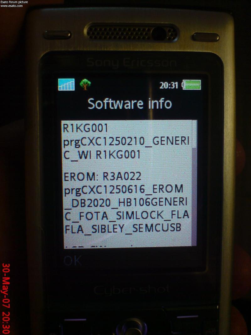

Rookwise
Joined: Mar 22, 2004
Posted: 2007-06-01 01:31
On 2007-06-01 00:34:00, aremaboy wrote:
Is the new EROM R3A022 obtainable via SEUS too? How could it be possible as SEUS didn't even upgrade old buggy EROM R3A011 to R3A016 in the past as there was no way to hold 2 plus 5 during the process..
I just had another K800 delivered from O2 for my mother. This was a Concrete Silver model K800 with O2 branding. When I checked the firmware it was R1KG001 and EROM was R3A022.
Have checked on Wotanserver and they do not have the new EROM either.
Pic's below to show:
aremaboy
Satio Silver
Joined: Nov 27, 2004
From: Malang, Indonesia
Posted: 2007-06-01 04:59
AFAIK, EROM can't be installed that easily neither via SEUS nor WotanServer or else. Look at Rookwise's EROM string. It doesn't mention the word WILMA anymore as most K800i does. It has the same EROM as K810i. Exactly. That's not a big problem..the new K800i products are with this new EROM. It's just a matter of product improvement I guess.
