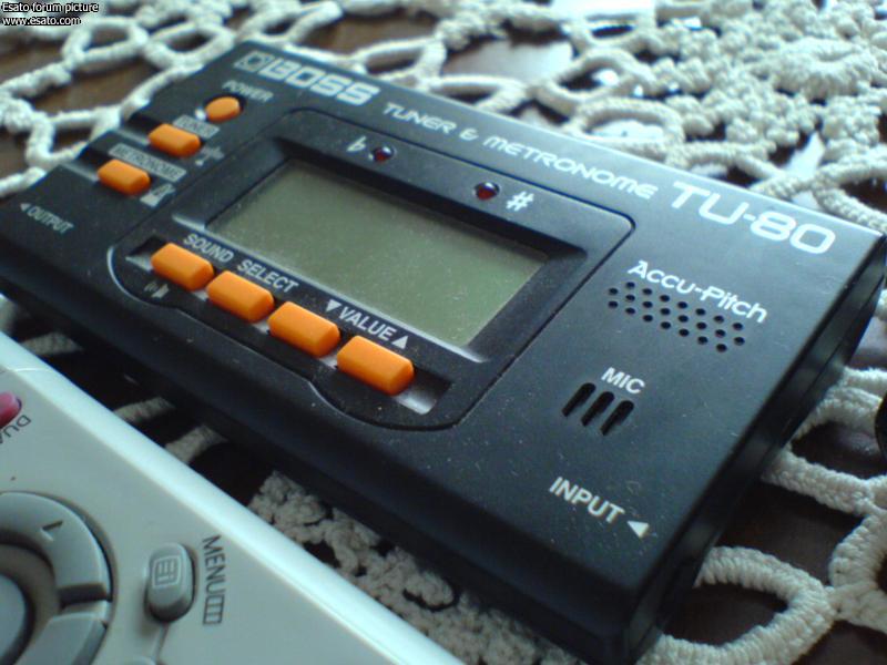

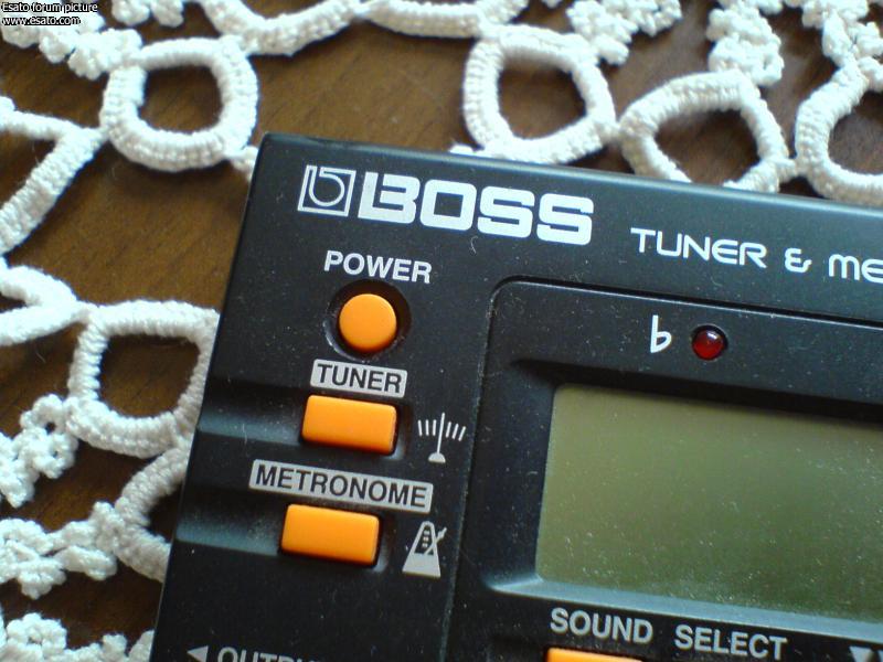

modded kiromag 21.91, manual focus
 I held the cam a bit closer to the object (60-70mm) then it's recommended..
 brightness: -1.3
 sarmad's would be perfect too, but sometimes when the object is a bit shaded it makes very overexponated and blury pics, like this. why?
 [ This Message was edited by: amorphis on 2007-06-01 23:30 ]
  [ This Message was edited by: amorphis on 2007-06-01 23:38 ] |
@amorphis
 thanks for compliment about my mod of Kriomag's drv - i still working on small things so maybe someday i will share with something new
 about that weird brightness on Sarmad's 5.7 - blame SPOT photometry (method of light metering) for that. BUT! i have to say very important thing before people total hate SPOT thing! SPOT is sometimes very usefull but it usage is rare. why Sarmad decide to put it as standard? i don't know but it's not good idea   we should have option to decide what type of light metering we want to use (we have 2 types).
 when SPOT metering is good? it's very easy...
 "Imagine, for instance, that you're trying to photograph someone who is standing in front of a brightly lit window. If you let the camera decide the exposure, the bright light from the window will radically underexpose your subject [very dark object]. So switch on the SPOT meter and expose the picture based on the subject. Yes, the window light will be overexposed, but that's okay--the important part of the picture is the person."
