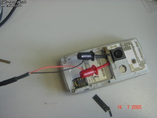

GsMen
C905 Black

I am almost sure its battery.
If you or anyone having the same problem, is technical enough to use direct power source to battery contacts, check my picture.
Open back cover with 2 screws, than gentle remove back cover. red wire = + approx 4 volts.

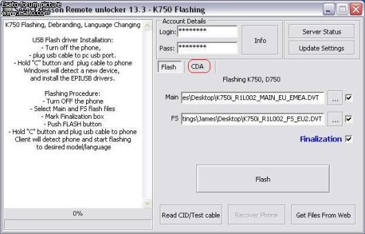

james123
Joined: Jul 14, 2005
Posted: 2005-07-14 21:25
hi guys, if i do this "flashing" thing to my k750i will get rid of the vodafone (uk) stuff and will it allow me to use the SEUS? do i need to tick or change anything else bar what i have (see picture) and do i have to do anything with the CDA tab that i highlighted in red

GsMen
C905 Black
Joined: Jul 16, 2002
Posts: 133
Posted: 2005-07-16 09:27
On 2005-07-16 03:40:45, ronymd wrote:
@Gsmen
so what is the purpose of opening, i mean what does it do to the phone after (im just curious) ?thanks
To attach direct power source, some people seem to have difficulties to attach phone to davinci, or seus, I (think!) its related to battery. Appying a direct source would 100% determine that
