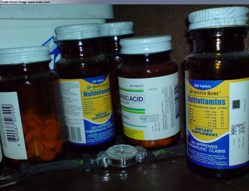

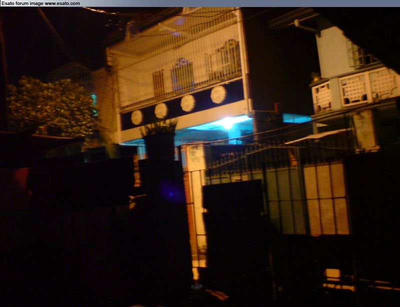

bryanjay420 Joined: Jan 18, 2008 Posts: 273 From: Pinas PM |
here are some samples...
your night pics are great even without flash...
it took the right scenery...i like it rather than special effects...
twilight landscape
document/flash on
