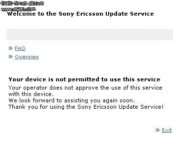

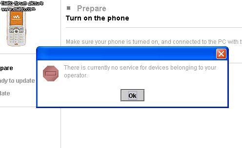

When I tried to update today on both the UK and Asian SEUS site, it says,
then,
The thing is my phone is unbranded and unlocked. It came that way direct from CPW. Does anyone have any ideas?
Cheers
Dan

i had the same problem, try going to the Asia pacific site, like Hong Kong English.
Anyone help with communication error?
