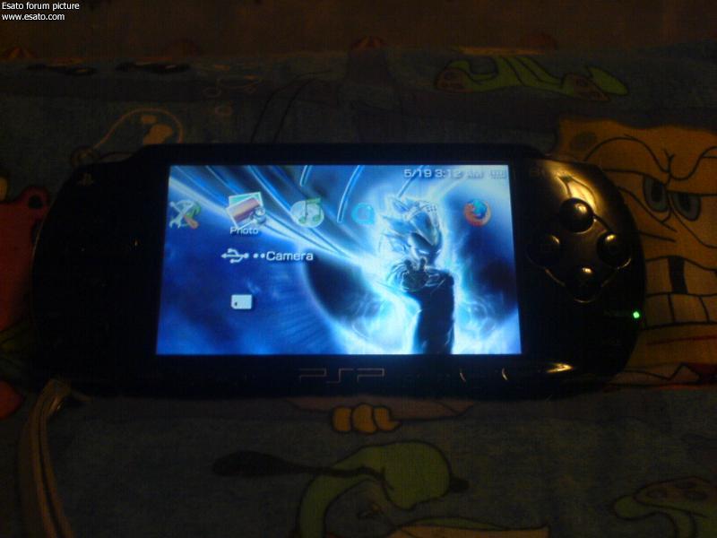

whatsucka
Joined: Feb 17, 2007
Posted: 2007-05-23 09:43
some pics with kriomag 21.91
this is my 1st time using 21.91 cuz i juz update it recently
my PSP
LED+ENM in pitch black room
ENM
download PSP Stuff here
[ This Message was edited by: whatsucka on 2007-05-23 08:45 ]
