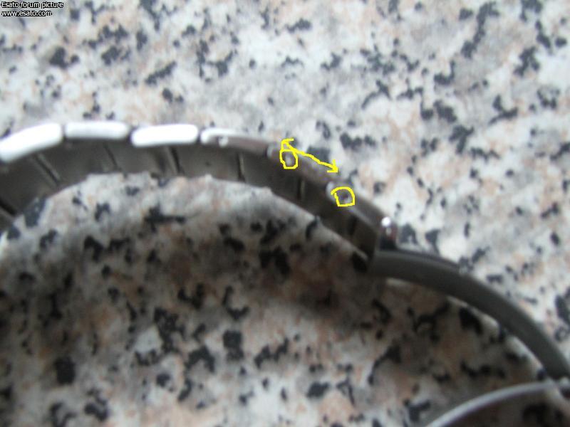

First I must appologise for the very poor quality of the images, I am have problems with cameras and can not seem to get macro mode to work correctly on my camera.

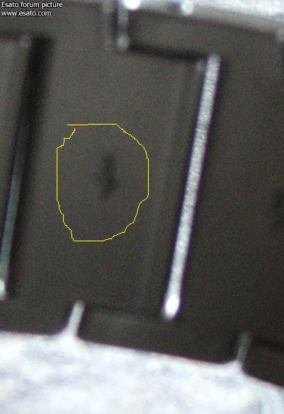

OK first pic is of the arrows on the strap showing the way they face.
This is the direction the pins should be removed.

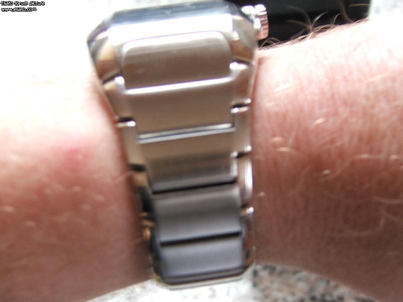

This pic shows the holes that house the pins, you will need a pin of some description, I used a strong darning pin, and a very small tap hammer to do the job. The pin needs very little force to come free, and it only needs the initial tap or two to move it, then you should be able to slide it out with your fingers. Make sure you put the pin back in the same way it came out, as you will see that the pin has a slightly thicker edge at one end, this is so that it sits securely in the strap. I found only one link on each side needed to be removed, as if you take links out of only one side, the watch will not sit straight on your wrist.
There are four pin holes on each side of the strap, and you only need to remove two pins on each side. I started nearest to the clasp, and took out the first pin then the second, which removes one link.
Any more questions about the strap let me know, and I will see what I can do.

Thanks for the instructions. I left my mbw-100 to a watch store and they removed 3 links from it. However that was actually still to big and since I dont feel like paying more money for something that should have been right the first time (and I don't bother taking it up with them) i just did it myself. Really simple infact as long as you can find a tool small enough to get the pin out.

Thanks for the instructions Volvoman, worked like a charm
