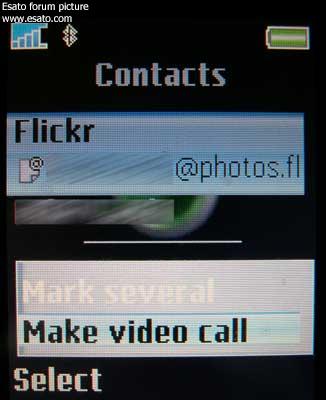

Video call option on the email contacts page.
