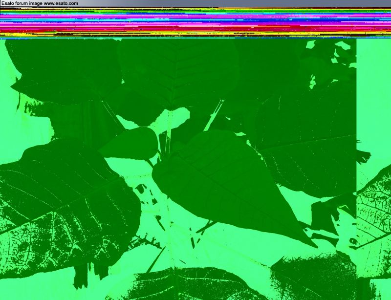

Posted: 2009-05-04 21:14
Hi darkmagician im stucked on my driver i just cant make it works, i mean i set manual ISO but when i take a pic it takes too long to be saved and it doesnt even saved right, the pic is wrong , but when i check it into my pc it gives me the correct ISO (the one i set), are you having the same issue???
i dont know where im wrong
i attach you one image to see what i mean

@eltoffer
Do you mind sharing THIS camdriver ? I wanna trick my friends that my camera broke
Nice pic
eltoffer
C905 Silver
Joined: Nov 01, 2007
Posts: 348
Posted: 2009-05-04 22:21
mmm if you want to use manual ISO and get this green effect you must enter to WB and then selec day or another settnig less auto
good luck

The schemma for ISO is a bit confused.
You canīt control two keys at the same time.Guys have to determine what they want and the priority to remove and implement another function.
If the function WB is not important to you is not very usual, then remove all functions with the WB or property WB whatever and implemented ISO function.
If the function effects is not important to you is not very usual, then remove the property effects and implemented ISO function.
Donīt need suffer so much guys, use the base of the k850
