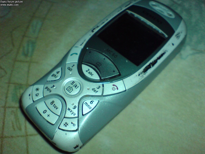

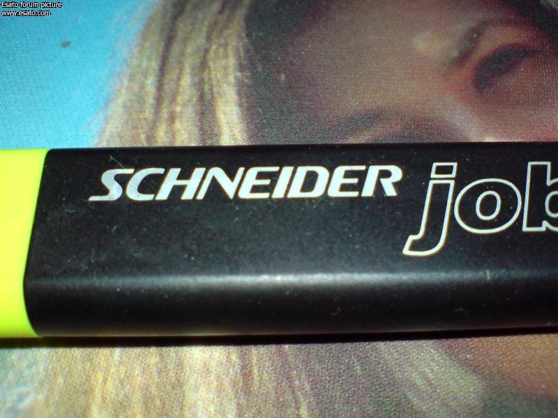

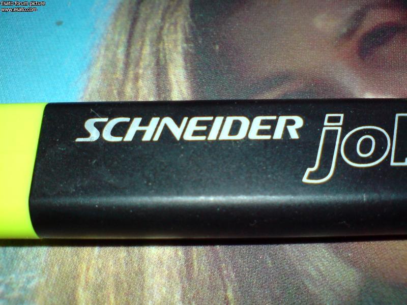

I know but problem is again here... I know in doc mode ISO is 100, but on first picture i dont get ISO 100...
Here is 2 pics, start camera, put document mode, put ev -2.0 take first picture, and then second...
There is EXIF, i only resized on 800x600...

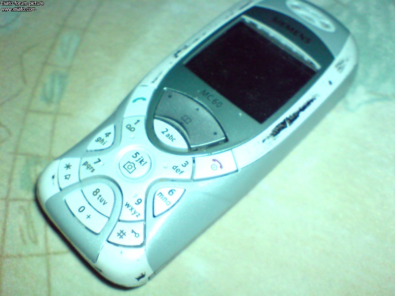

i did what you said... :
picture 1
picture 2
[ This Message was edited by: yorulezkos on 2008-01-26 20:50 ]

Found it, the problem is with the force flash, and is solved setting document mode twice, I'll try to fix it in next days
