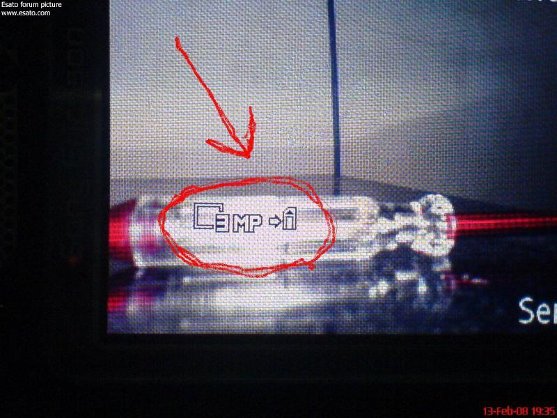

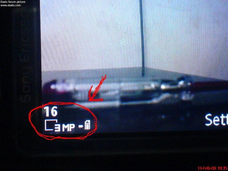

apekgee Joined: Dec 14, 2007 Posts: 4 PM |
after flash my phone from k800  to k810.. i try to take some pic..
 but something wrong about the layout.. help me plzz
 before take pic..
 after take n save pic in memory..

centur Joined: Jun 10, 2007 Posts: > 500 From: Bulgaria PM, WWW
 before take pic..
 Click on my signature and open folder Modding_K800i_CID52:
 own_custpack_-_K800i_original_layout.rar
 own_custpack_-_K810i_original_layout.rar
