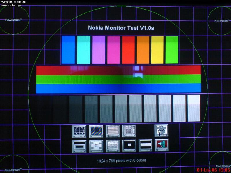

Russian v5.5b
macro 1/2 m distance ,fine mode, daylight
fine mode , daylight

Thanks for test snapshots. And where is the comment?
