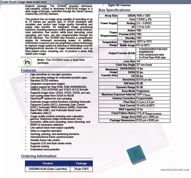

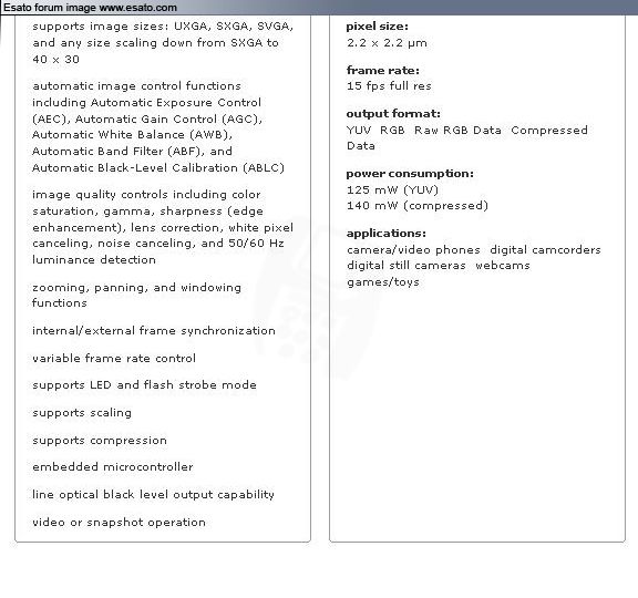

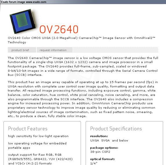

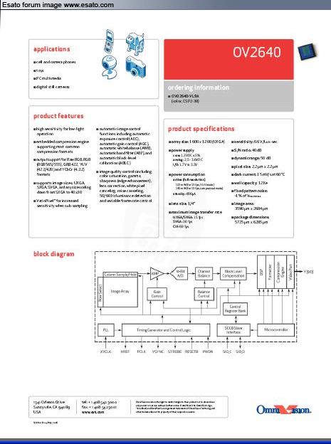

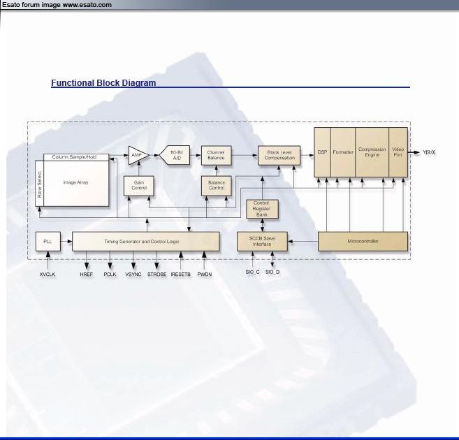

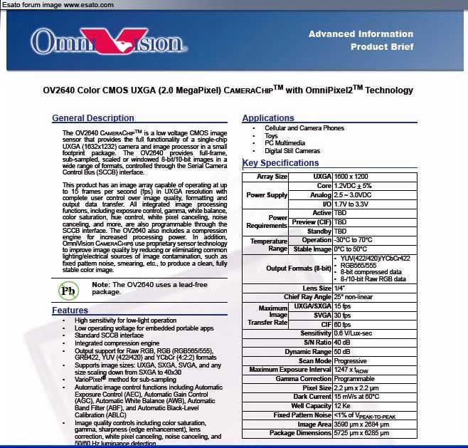

OMNIVISION
OV2640 Camera Chip 2MPixel
OV2640 Features and Specifications:
OV2640 DataSheet
[ This Message was edited by: brazuka on 2008-03-03 17:03 ] |

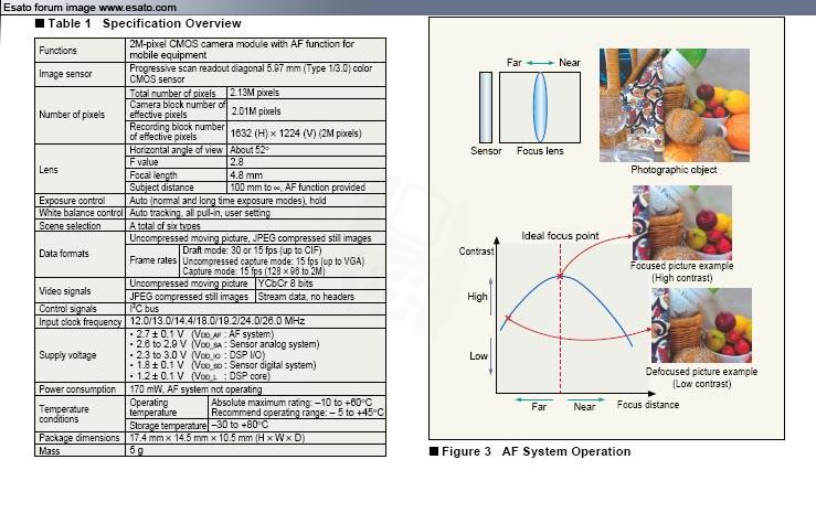

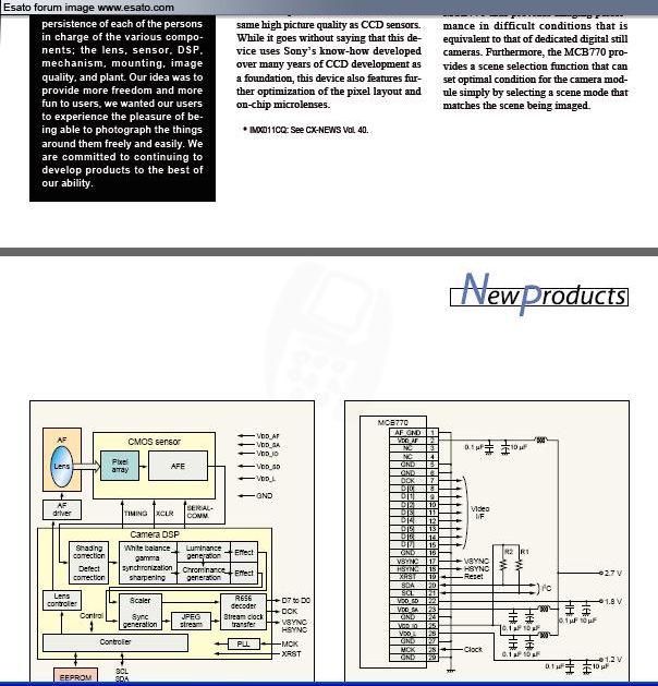

brazzuka's Joined: Nov 14, 2007 Posts: > 500 From: South World-Antartida-Sweden PM, WWW

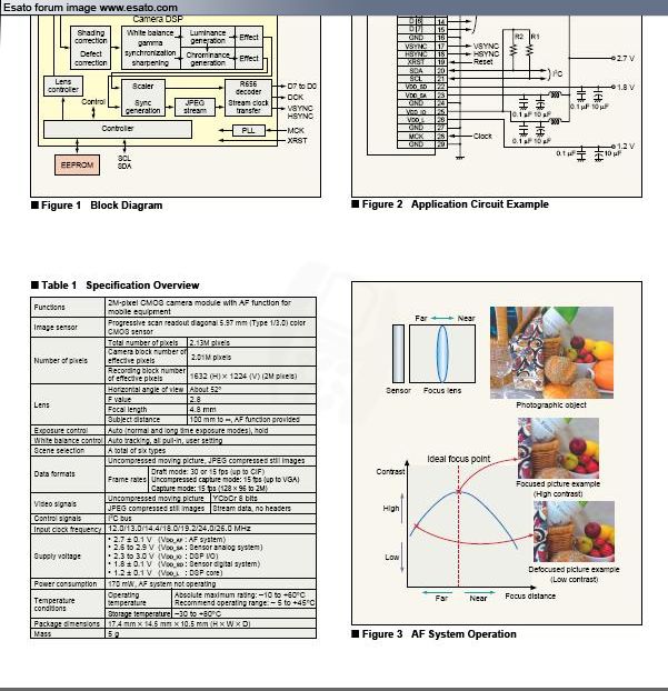

Sony MCB770 2MPixel
number1 Joined: Sep 12, 2007 Posts: > 500 From: UK,kent,Sittingbourne PM |
i was looking at the OMNIVISION site 2day, it's not as useful as the micron one, also i can't find any info on
samsung techwin 1200-0112 or sony MCB881
