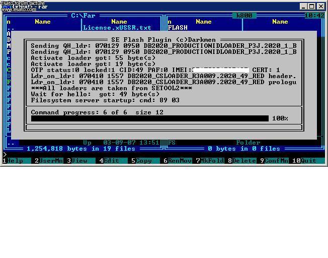

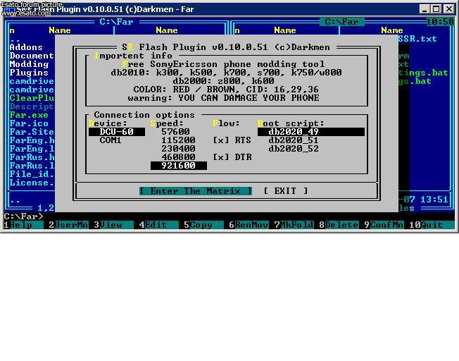

Sorry to break in a discussion, but my FAR isn't working any more. It did before I having a K800i vodafone branded with cid 49. Suddenly FAR can't start some server anymore. Someone had this problem before?
And than it stops!!! Is this the end of modding?
