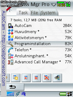

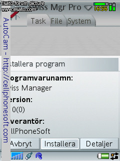

nabboR
P990 no flip
Joined: Dec 03, 2006
Posts: 62
Posted: 2007-02-08 17:13
Hi Lisa!
This is what it looks like. (hope the pics are uploaded)
I took me the liberty of DL your AutoCam, just to be able to show you. Nice toy!!
thus, it is Swiss M ver. 1.10 that wants to be installed everytime I turn my phone on and starts SMpro 1.43, I've tried to install it again in hope to make it go away but it still pops up every time I turn on the phone.

nabboR
P990 no flip
Posts: 62
Posted: 2007-02-09 17:41
Hi Lisa!
"look what's shown in the Information tab. Let us know what is the App file and the UID"
UID is 10000419
App file is QAppInst.exe
Path: Z:\\sys\\bin\\
Document: C:\\Private\\10000419
Etc.
I'm at my work now so I can't upload any AutoCam pics.
Booth the Z:sys and C:Private are folders that I can not do anything about, they're protected.
Any tips to get rid of it?
