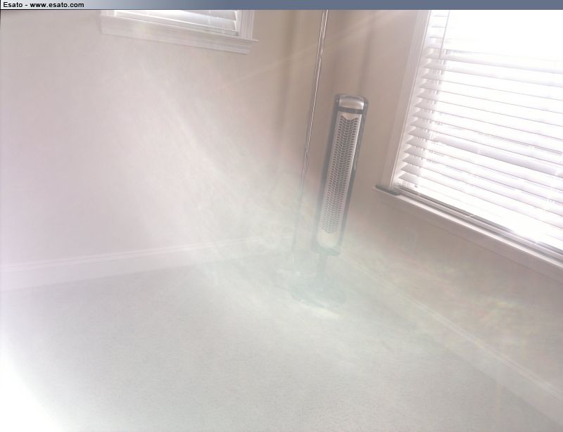

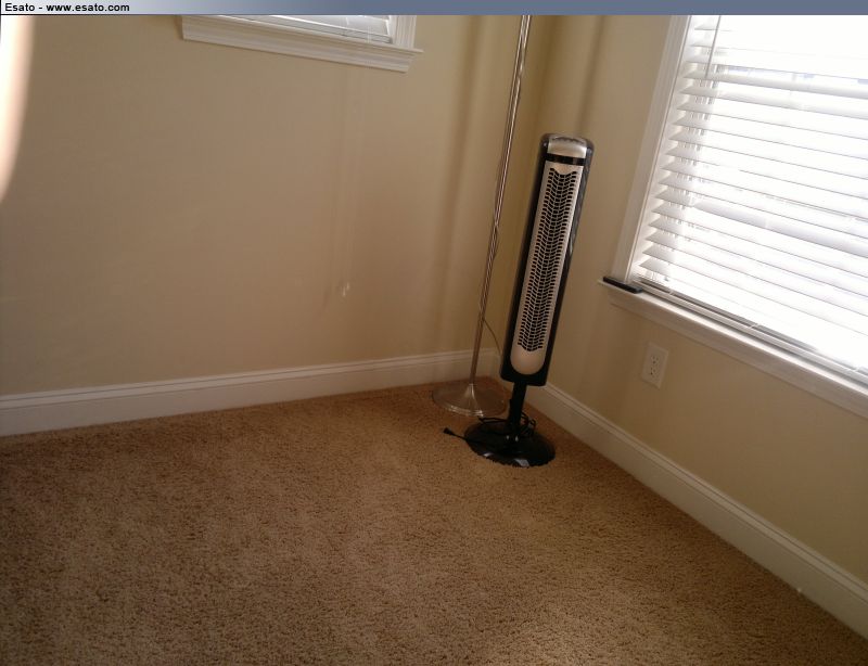

I believe the bad flare issue is indeed caused by the silver ring and is easy to dupliate... in the photo below you can clearly see a curved shape flare which IMO is the silver ring around the lens (my N8 is orange).
If I simply place my finger to the right of the lens (seperating it from the light) you get this...
*my finger entering the camera lens to left is only to show HOW MUCH light is reflecting right there.....
Do you think if Nokia were or are aware of this would they see it as an issue or not?? Would they release future N8's with no silver outline?? Would they replace existing models or would that be far too expensive for them?? I guess it could put their long awaited flag ship N8 in a bad light(no pun intended)

I highly doubt they will do anything about it.... my C905a does the same thing and once your aware of the issue the solution is simple. A) try not to shoot toward bright light (ie, keep sun at your back) unless your intending to add flare to your image.. or B) just use your finger/hand to block the sun/light in those situations.... Not really a HUGE issue IMO

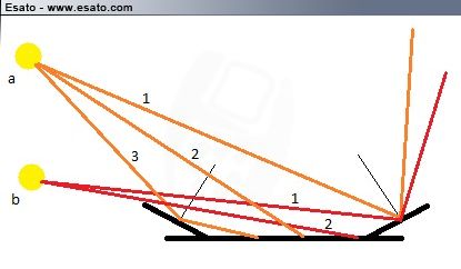

You simplified things too much!
And you missed some major points.
Anyway, going with your simplified basic explanation, here the points you missed:
In the picture above are two light sources, "a" and "b".
Source "a" emitting three rays, and "b" two rays.
The perpendicular black line is the Normal line to the ring's planar area.
Given the necessary conditions, those rays should reflect at the same angle they make with the Normal.
Orange1 and Red1 relflect away from the lens.
Orange2 and Red2 go directly into the lens and refract, probably causing not only flares but also artifacts.
Orange3 is our "special" ray. It reflects from the ring into lens.
Now, the issue here, for a source to emit such rays that reflect into the lens, two conditions should be met:
- That ray hits the outer region of the Normal. In this case, O3 hits the left side of the Normal.
- It should hit it at an angle greater than 45°.. Depends however on the position of the spot hit on the ring, and the curvature of the ring as well.. It could need up to 60° to make it through the lens for instanace..
However, to meet those two conditions, teh source must be within the view, in other words visible in the viewfinder! Which means it's already resulting in some excessive amount of light in and flares already there..
In the other case of Source "b", the source shouldn't be visible to the camera, but could still result in some flares (Etaab's photos!!)..
But not caused by ring reflection..
However, capturing photos whereas the light source isn't producing rays directly into the lens shouldn't result in any flares. This happens when one makes sure that source is well maintained by the right angle of view.. |

When I said that there is no way for light to bounce at negative angle and into the lens, I was referring at teh case of Source "b" illustrated in the drawing I posted. Same as what happened in teh two photos of Etaab for instance.. The source isn't within the angle of view!
However, if you have some bright light source within the angle of view of the camera, it will result in flares anyway..
Now, you can argue that the ring may make it even worse. Ok, in this case I could agree. But there's no point here blaming the ring for flares as those would already be there!
Then, as to the simplification I hinted to.. You missed that the material the ring made of isn't a perfect reflecting one!
And you missed the curving part of it..
There are many given conditoins here if considered would lead for the most of light not ot be refeclted at teh first place!
Flares mainly occur of excessive light entering the lens directly and refracting. Light bouncing off objects, even extremely near objects, shouldn't be a problem!
That's why I said I'm not very sure in my first post. There's many diverse aspects to consider and you simplified things too much.
In conclusion, if that ring does have some negative effect, it's due to only when the camera facing a light source, which isn't that wise to do, and the effect is minimal in comparison to the rather natural flare effect taking place at that condition!
Again, notice the "if's"... |
