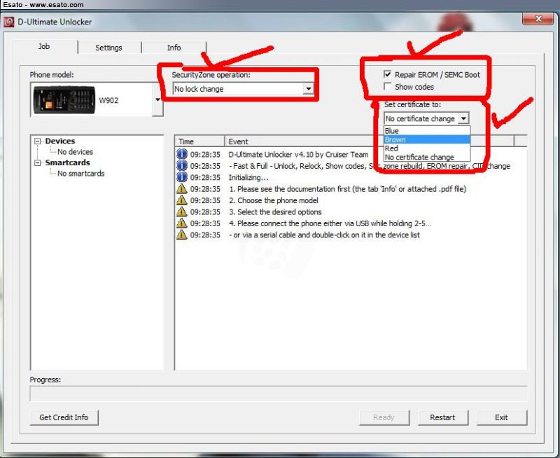

Ok.But what abut the 'set certificate to' option! What i must select. Blue brown or red?
select brown.. and REMEMBER....!!!! DO EXACTLY AS IN THE TUTORIAL....!!!!
some extracts here...
1. Start Up Aerix & enter your registered acount details by pressing the "settings" button. (DID U REG. FOR ARIX..?)
2. Press Unlock.
3. Remove your battery and reinsert it.
4. Connect holding 2+5 buttons down.
5. Wait for a while, but keep watching. This is where timing is of the essence!
6. As soon as it says "Restarting Phone" OR "Phone Restarts" in the log, etc. HIT ABORT!
7. Aerix will then stop immediately and give 3-4 error messages in the log. Your phone is now blue. But we need brown to patch. wink.gif
8. Now, open up D-Ultimate Unlocker.
9. Choose your phone, and tick Repair EROM/SEMCBOOT.
10. Set certificate to BROWN.
11. Select "No Lock Change".
12. Now connect your phone, holding 2+5 down once more.
13. Wait until the entire process finishes. Now your phone is brown and ready to patch
