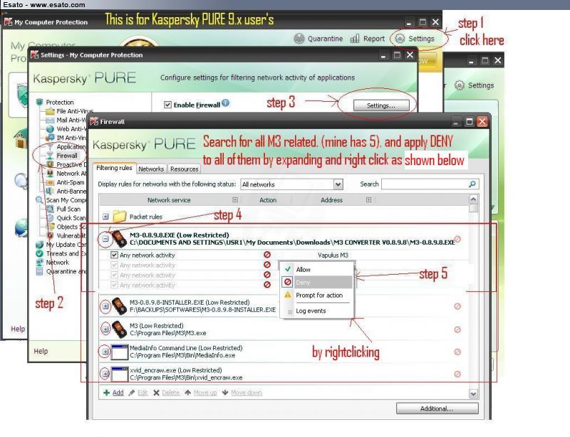

kookoo Joined: Apr 10, 2009 Posts: 9 PM |
wow after blocking all the m3 network activity, now its working good as before.. hey guys u saved me..
herewith i attached a picture what i did to work
