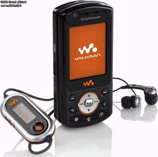

The real and powerful W900...Para nosotro es dificil de tener porque Digitel tendría que cambiar su frecuencia de operación...funciona a 2100 Mhz
470MB user free memory
The storage capacity is easily increased however by inserting a Memory Stick PRO Duo, currently available in retail outlets at up to 2GB
2.2 inch QVGA 262K TFT screen
2 Megapixel, autofocus camera with LED flash
UMTS
available end Q4 2005
