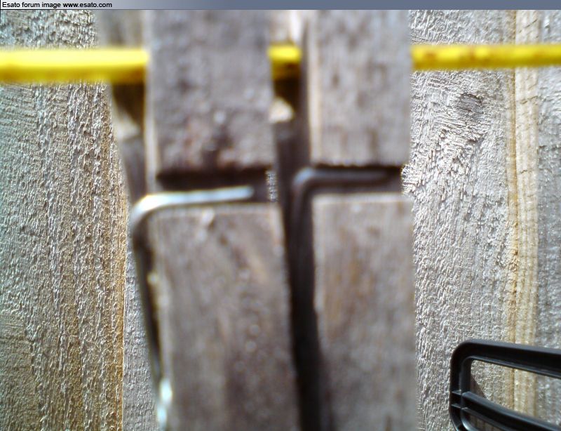

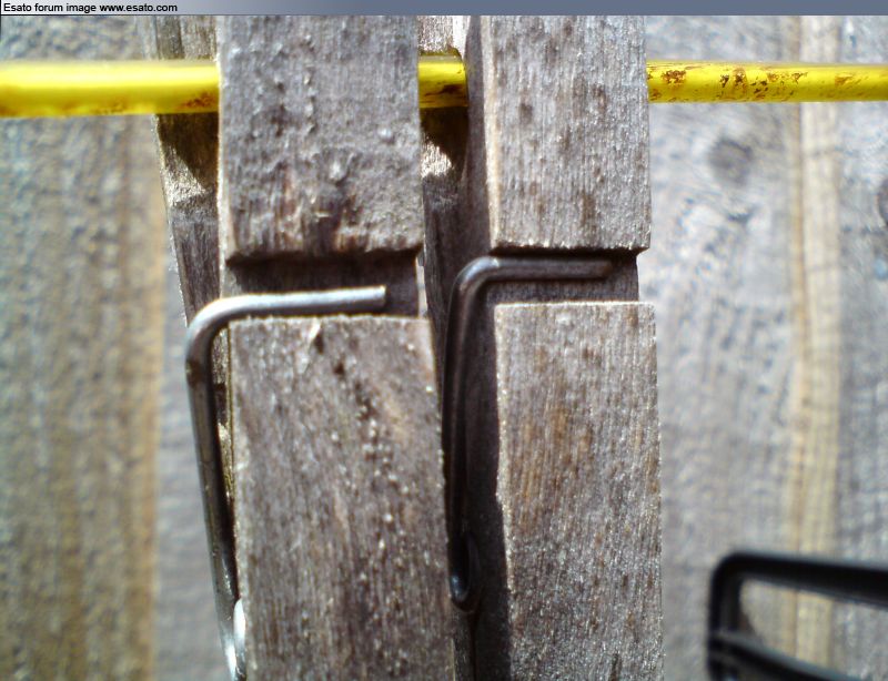

This test is done using Fast Stone Image Viewer (free download available at Filehippo.com)
All images are 100% crop. EV steps are written on along the exif data. EV step represents manual focus adjust, not actual exposure value. According to code, this camdriver has a little bit changes from the code alpha posted in this thread.
Subject approx distance (15cm: from thumb to index finger span)
Subject approx distance (7~9cm: index finger length)
Hope this helps.. Will proceed with more tests, if internet connection is good
