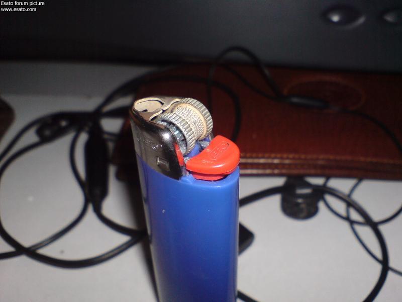

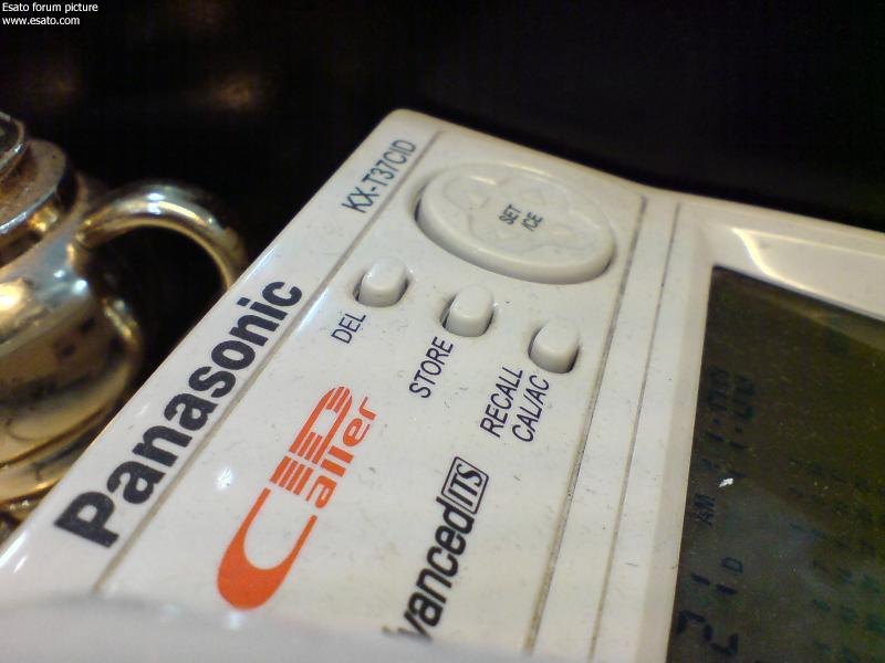

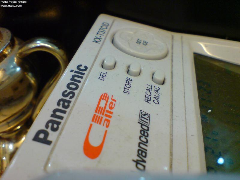

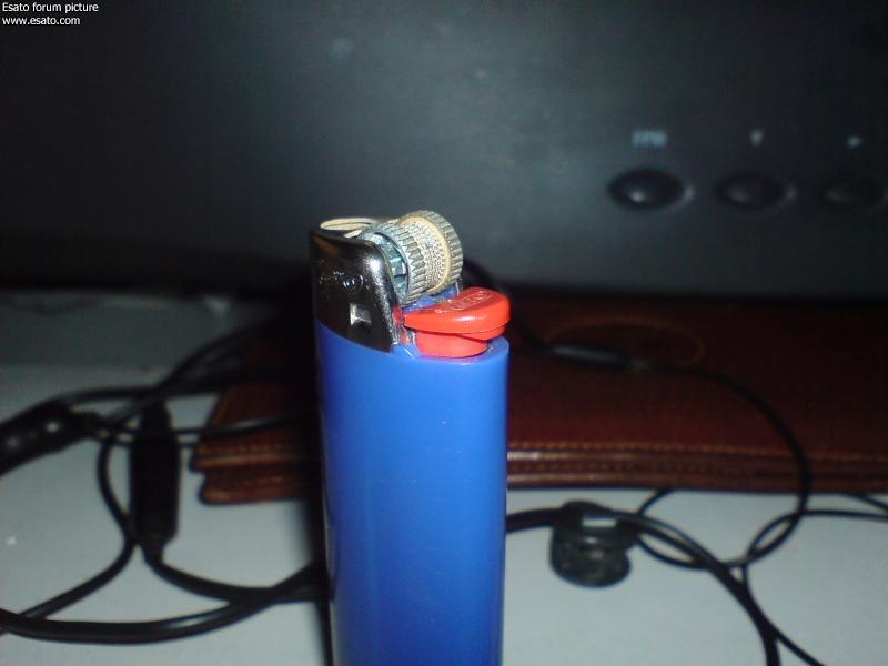

compare genus 5.7 (sharpness 07) & Kop 2.7 fix (sharpness max 08)
Document mode, auto all:
Genus 5.7
Kop 2.7 fix
chonggi
Joined: Nov 08, 2007
Posts: 52
From: Pilipinas!
Posted: 2007-12-21 05:47
what's the actual color of the "caller id" text on that pic?

"Caller ID" text is deep orange. I thinks Genus 5.7 give right colour but a little dark. I hope Genus can fix it.

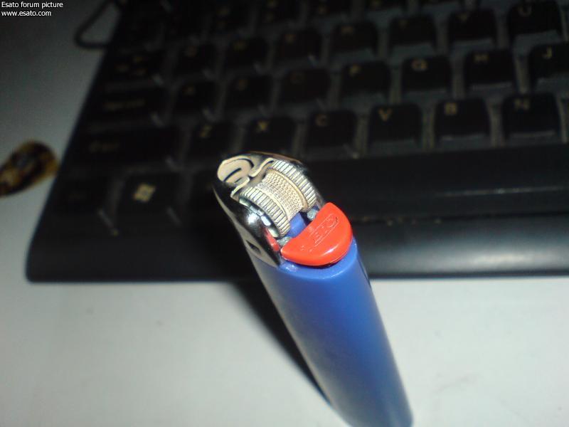

kopritis 2.7 +8 sharpness
kopritis 2.7 + 3.7 100% fix
kopritis 3.71 final mod
i really dont know...its up to you guys
