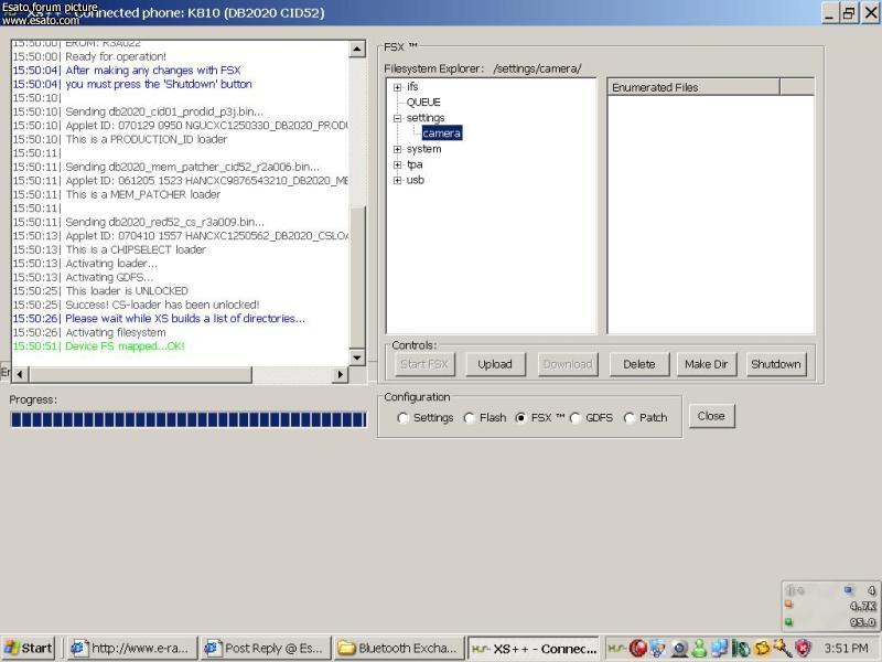

Can i ask something pls...when i tried to install your driver with XS++ i saw that there is another camera0.dat in settings (not ifs).Whats that for?Cause i accidentally erased it and now i don't have it anymore.
And i read all the tutorials and suggestions till now but i still get awful results with every camera driver except the default...Any help would be appreciated.
I'll include a photo to show you where it was.
