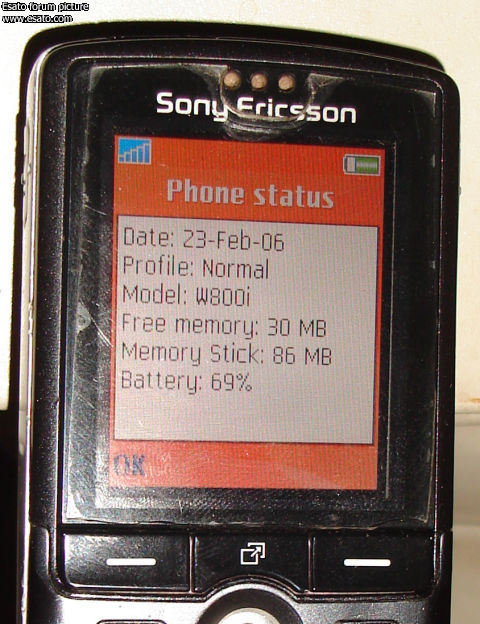

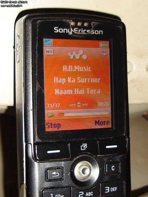

Yippeeee!!! I finally got my W750 (W800-K750 Hybid), lots of thanks to everybody on this forum. Well, it was the most anxiouw moments 1 ever experienced (well, 1st time flasher!)
Here are some pix:
Walkman Player
This one was taken with the fone
http://www.esato.com/phonephotos/viewphotos.php?pid=899
Special thanks to Tigrente for sending the bin files, and others in this thread, mb-new, mobilematze, and of course, Darkmen, for developing this wonder-tool!
