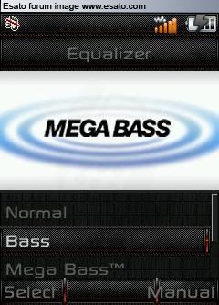

I used A patch which gives me both BASS and MEGA BASS equilizers.
So how to patch mobile so that the MEGA BASS image is shown when i select eh MEGABASS and not the BASS.

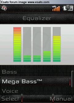

firoz3321
Joined: Aug 29, 2008
From: AP, INDIA
Posted: 2009-01-30 14:15
On 2009-01-29 18:28:48, H_rY wrote:
just using 1 Mega Bass patches. like me i'm just change my Bass to Mega Bass. some patches change voice to mega bass.
so if you already have the other, remove them before.
But i think it added an extra equilizer item. I have :
Normal
Bass
Mega Bass
Voice
Treble Boost
Bass is giving the Nice Bass.
Mega Bass is giving Very High BASS.
I used some modified Equilizer Patch.
Any way. I will remove the Patch
But the Modified Bass Is NICE

I used this Patch:
;K800 R8BF003
;MegaBass [Modded Equalizer]
;v1
;(c)diezil
;(p)gunot12
+44140000
f06876: 042D 052D
f06898: 0420 0520
f06a34: 0521 0621
f06a66: 0521 0621
f06ad4: 0421 0521
f06b04: 0528 0628
f0f61e: 0528 0628
f0f730: 052B 062B
f0f788: E457B845 64CFD945
f06840: D837B845 4CCFD945
1c5cf4c: 00000000000000000000000000000000 8B1000003F10000074100000E1100000
1C5CF5C: 0000000000000000 BF100000FFFF0000
;1C5CF64: 0000000000 0000000000 ;normal
;1C5CF69: 0000000000 0500000003 ;bass
;1C5CF6E: 0000000000 0E00000003 ;mega bass™
;1C5CF73: 0000000000 0000000600 ;voice
;1C5CF78: 0000000000 0000000006 ;treble
;Modded Equalizer values by Witchking
1C5CF64: 0000000000 0605020506 ;normal
1C5CF69: 0000000000 0C07040608 ;bass
1C5CF6E: 0000000000 0E0A04070B ;mega bass™
1C5CF73: 0000000000 0705060B07 ;voice
1C5CF78: 0000000000 0706040A0C ;treble

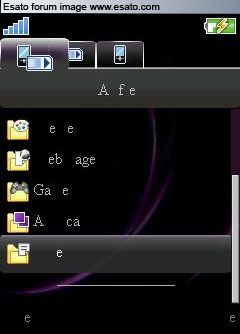

So i want to make a patch fonts to usb/other/tpa/fonts for k800 r8bf003 , there is a patch fonts to other but it doesnt work , so i've made this , but it doesnt work and i don't know where is the problem , i use far manager for patching (cid53).
;K800 R8BF003
;/tpa/preset/system/fonts -> /usb/other/tpa/fonts
;By Shashmahal
;create folders and copy files before patching
+44140000
16F5E2E: 7400700061002F007000720065007300650074002F00730079007300740065006D002F0066006F006E00740073 7500730062002F006F0074006800650072002F007400700061002F0066006F006E007400730000000000000000
[ This Message was edited by: shashmahal on 2009-01-30 21:04 ]
[ This Message was edited by: shashmahal on 2009-01-30 21:30 ]
Boysie

shashmahal
Joined: Jan 03, 2009
Posts: 6
From: Bulgaria
Posted: 2009-01-30 22:43
exactly this patch that u have been posted its not working , ive tried it

shashmahal
Posts: 6
From: Bulgaria
Posted: 2009-01-30 22:55
yes , ive tried it , its buggy
so that's my final version of the patch:

this is a screen what happens when i put one of these patches
look the font , its all bugged
[ This Message was edited by: shashmahal on 2009-01-31 02:59 ]

Posted: 2009-01-31 10:01
Right. This patch works cos I've tested it.....
;K800 SW-R8BF003
;/tpa/preset/system/fonts -> /usb/other/se/fonts
;By Copini
;(p) Bizon69
+44140000
16608D4: 2F007400700061002F00700072006500 2F007500730062002F006F0074006800
16608E4: 7300650074002F007300790073007400 650072002F00730065002F0066006F00
16608F4: 65006D002F0066006F006E0074007300 6E00740073002F0066006F006E007400
1660904: 2F0066006F006E00740073002E007800 73002E0078006D006C00000000000000
1660914: 6D006C00 00000000
16F5E2C: 2F007400700061002F00700072006500 2F007500730062002F006F0074006800
16F5E3C: 7300650074002F007300790073007400 650072002F00730065002F0066006F00
16F5E4C: 65006D002F0066006F006E0074007300 6E007400730000000000000000000000
....BUT it only changes the location of the "FONTS.XML" file.
The FONTS.XML contains the location of the *.ttf files so that then has to be modified to suit the patch so you'll have to edit the FONTS.XML of all your fonts...which seems a little pointless to me!
So basically don't bother with this...its a waste of time.

shashmahal
Posts: 6
From: Bulgaria
Posted: 2009-01-31 13:43
no , the bug is that , the xml dont change location , because when i put other fonts in usb/other/tpa/fonts , the fonts get messy but when i put in the same folder usb/other/tpa/fonts the font that are from the FS in the phone , everything goes ok
I think that the phone after this patch keeps reading fonts.xml from tpa/preset/system/fonts , and the fonts from the folder usb/other/tpa/fonts
