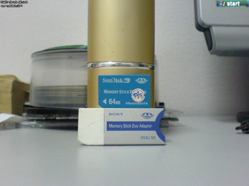

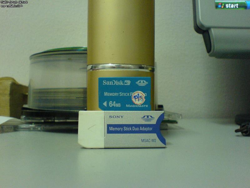

QuickShare Joined: May 06, 2006 Posts: > 500 From: MYR PM |
Both with Macro+Nightmode= ON
2.42 Hybrid
2.41 Hybrid
Conclusion
ok i like the sharpness and focus capability on the new 2.42 Hybrid.. but the colour was.. how to say this, yellow-ish? i know you can fix that tiny little problem aksd
2.42 Hybrid
2.41 Hybrid
Conclusion
My K750i Flickr Site..
Flickr.com
Most Popular Newbie 2006
[ This Message was edited by: QuickShare™ on 2006-09-18 17:27 ]
nice pictures ! so what you think that is good one?....for example ....can you make without macro and in normal mode some pictures?:) between 2.41 and 2.42 to see also there the sharp?!:) and what is with this ,,,yellow-ish,,what you mean?
