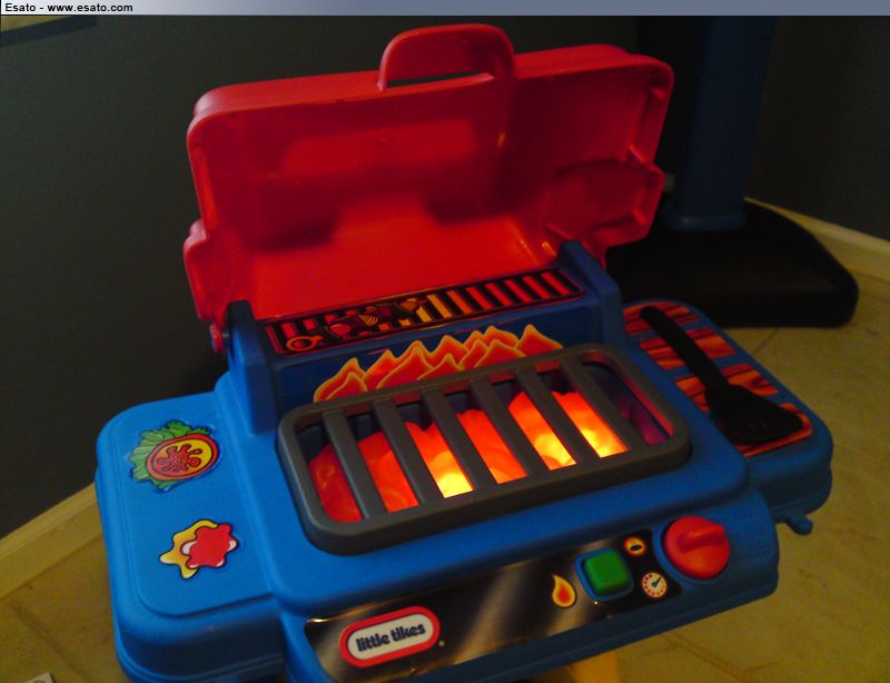

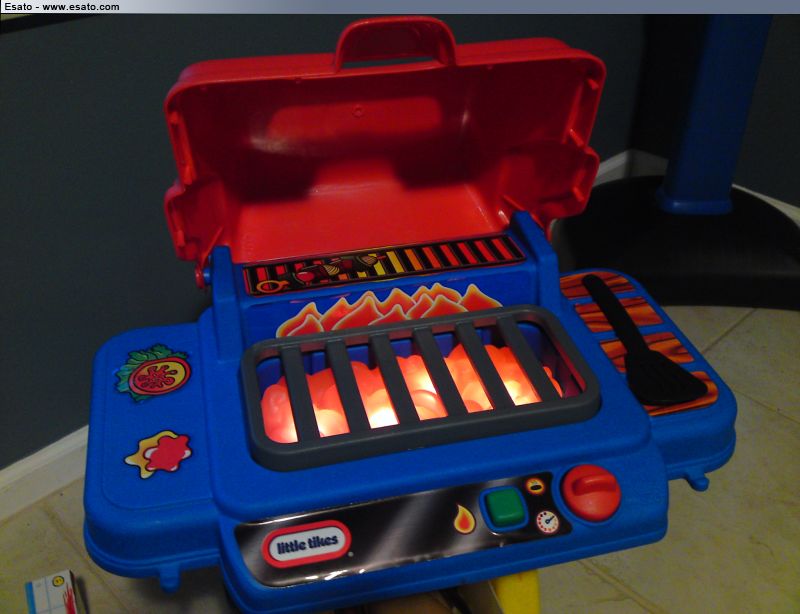

ok guys, here are 2 more comparison shots.. DM3.5 vs DM3.8
Both taken in low lighting, NO flash, twilight portrait setting + EV-1.3
DM 3.5
DM 3.8

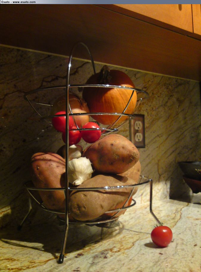

Here is one more indoor shot... DM3.5 twilight portrait - all AUTO.

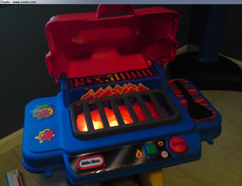

Ok, i just took this picture now with DM3.8, indoor nightime, low lighting. ISO200 with shutter speed cranked up to EV+2.0
Exposure time for this picture shows as 1/5 sec.. If i have the shutter speed setting cranked up to EV+2.0, shouldnt I get a slower shutter speed than 1/5 sec?

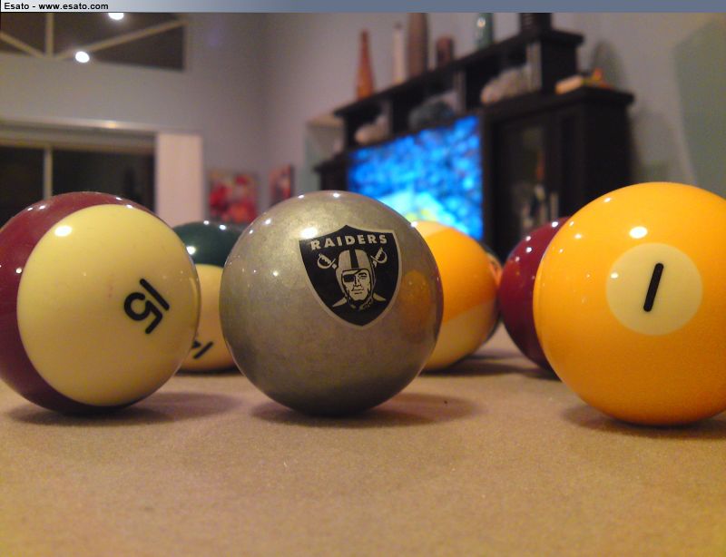

i am starting to like DM 3.8 more...
I would of never thought a cell phone camera could take a picture like this.. at night, no flash, in semi-low lighting, and come out so good.
This camera on the C905 is truly great.. and with DM & the other modders here, its better than any point and shoot digicam i have ever owned..

the best way to experience shutter speed lesson is by playing with it. Just play with the setting for a moment and see if you set the EV down/up, it will make the picture darker or brighter.
Shutter speed not only able to adjust the light, but also can create some artistic light effect for moving object for ex : car light.
Now to answer your question. I think 1/5 sec probably the lowest speed setting this camera can get. try to adjust to -1 and see what is the exposure time gonna be.

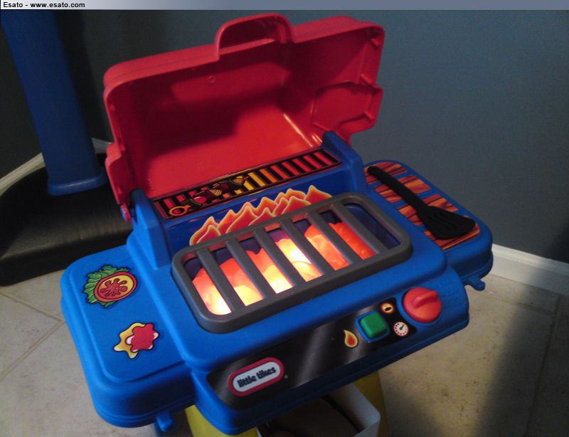

DM3.8..shutter speed 1/2 sec!
ISO 200
again, this is low light, indoor night, no flash.. DM3.8 is the best i think!
