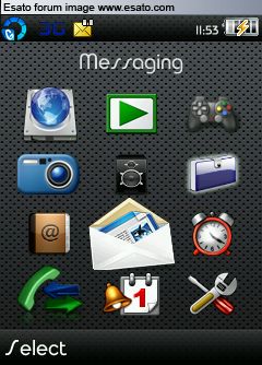

hi, got a few problems with my phone so here goes... i have full elfpack on my phone as download(boysies), and my heap at the moment is 7532736. In my cam pics album half my photos show up and half it doesnt show, is this a memory problem caused by mega elf pack? and secondly.... i have sysgfx patch on my phone with quite a few images in ini gfx folder, put a load more in yesterday, turned phone on and all my main menu icons didnt show, as well as some icons generally in my phone? anyone have an idea of the capabilities of sysgfx patch?......rga
Boysie Joined: Jan 17, 2008 Posts: > 500 From: Southampton, England PM |
Hi mate. This is a common problem caused by alot of modding. The SYSGFX patch is limited in the amount of images you can display with it. I stopped using it for this exact problem ur getting.
Even tho ur heap is good, there are other factors that cause broken/missing images which i dont fully understand.
Basically, dont use too many Sysgfx and dont store too many pics.

ok sound as a pound.I have some graphic patches which have been on for a long time, but to be honest i made a sysgfx pack of all message icons in phone and tried to apply in gfxini, thinh there was 94 images or summat so no suprise there, will try to scale down. and try again.Got my head around elfpack now more or less, will choose elfs i want to keep and look at deleting some of the others...liking my phone at the moment to be honest!
