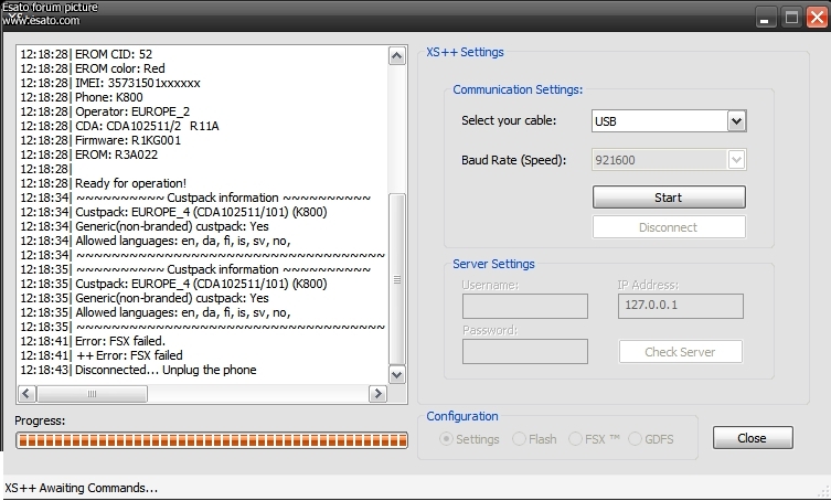

orite i tell you everything i dun installed the flash plugins then downloaded a custom menu off max wedge then put it in the files to upload folder with the write directory you know tpa preset system menu then i hold down c connect my phone on configoration flash is ticked then customize file systems then i click break xs then i go to fsx 'configuration then start fsx then i get an error plz help many thanks

most likely you don't have the correct folders.
if it fails at FSX- make sure you have a "files_to_upload" folder.
Inside that make a tpa folder. Then inside the tpa folder make a preset folder, then inside the preset folder make a system folder, and inside the system folder make a menu folder. You will lend up with a path like this files_to_upload/tpa/preset/system/menu (within the XS++ folder)
Inside menu folder, place the menu.ml and icons files. Then try FSX again.
EDIT: just saw your post, sorry. Yep it looks like you did everything right.
Oh and buy the way, I think I misspelled the folder: it's files_to_upload (I left the frickin' L out) D'oh!

Posted: 2007-08-29 12:29
cheerz you made it work max wedge
