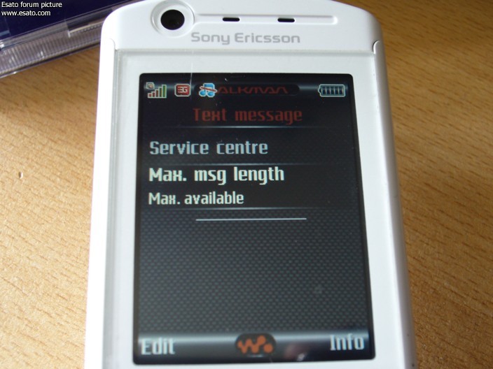

here the only options i have are:
Service Centre
and Max.msg length
thanks for all your help! |

w3bby Joined: Mar 13, 2006 Posts: 15 PM |
Any ideas as to why i don't get these options then?! As i do have the same vershion as you! |

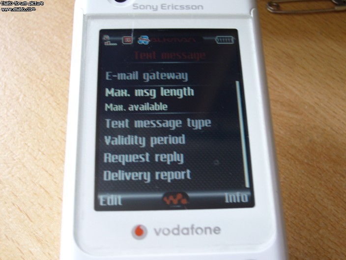

Hi w3bby, I have identical software, but I seem to have a full range of SMS options - Sevice centre, Email gateway, Max msg. length, Text message type, Validity period, Request reply, Delivery report.

w3bby - you just get two option with three (3)
but with vodafone.....
yeah thats the screen exactly as i see it (exept mines a simfree phone,and mines is a symbol it doesn't say '3G' when i have 3 signal (thats besides the point))
But '3' supports the delivery reports, so why should it not work? |
