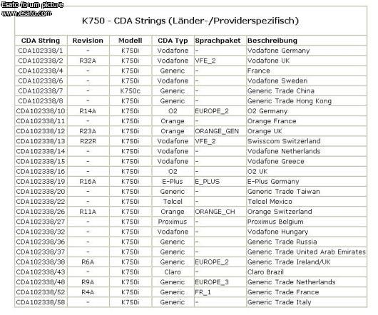

I have CDA102338/38 and the SEUS downloads the correct EU2 firmware.
It must be said that the CDA does not determine whether or not the SEUS will work - that is done based on the IMEI. So if your operator blocks use of the SEUS, unbranded or not, CDA changed or not, your handset will still not work with the SEUS. The CDA simple tells it which firmware to download, but your phone must be allowed before this comes into play. [addsig]

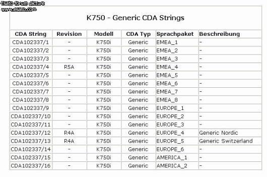

I have found this. Attention it is not complete. There are missing some revision numbers. There you can see that CDA102337/10 is generic
for Europe 2.

Yes but if its not working with SEUS, thats no good - best if people stick with CDA102338/38 R6A for now I think.
