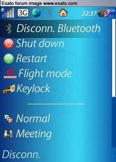

New patch to add BT to On/Off menu....
;k810 SW-R8BA024
;Add the menu, causing the button onoff item onoff Bluetooth
;Compatible with patch "Adds item on the menu Restarting the phone and called on the button On / Off"
;v.1 fix.

;K800 SW-R8BF003
;Add the menu, causing the button on/off item on/off Bluetooth.
;v.1 fix.
;© 2007KrasH

K800 GTi R8BF003 Tartes elfpack v1.9.1 and 50+ patches! Elfpack Dload
K800 Patches Dload
[ This Message was edited by: Boysie99 on 2009-01-24 23:24 ]
