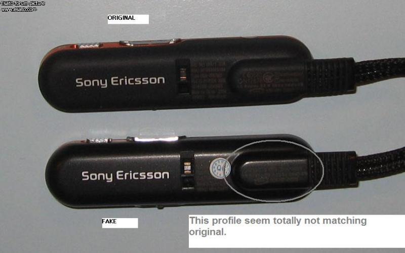

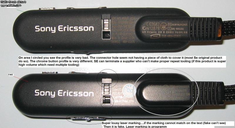

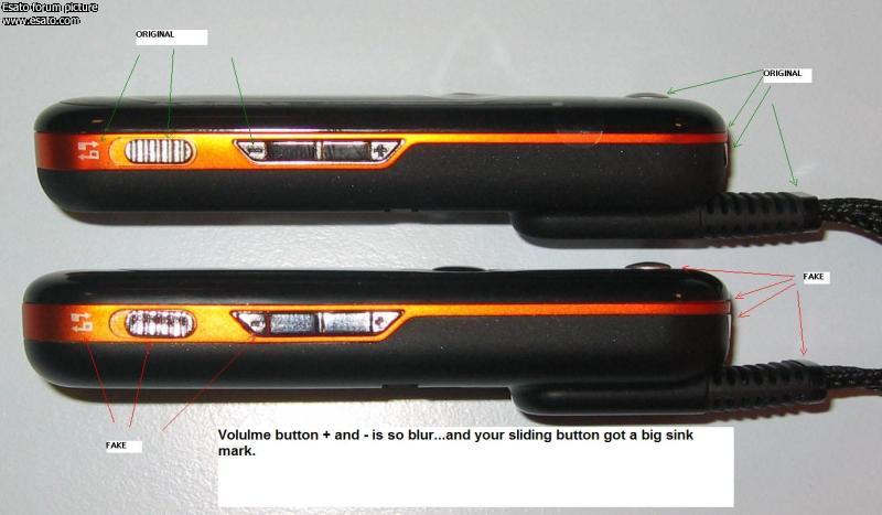

Marcellos
I only look into this just now
SE icon is so different...the small opening to expose the green should not be that small
here's other comment on the fake one. One thing i didn't put in the picture....the casing which is original come with all the marking for material etc but fake one none
I didn't browse thru the whole thread but to me it is good to bring this up to ebay.
there's another theory from me....just wonder have SE changed the supplier of plastic but I doubt this is the likely situation...becauae I don't think they will allow one supplier who can't even provide an icon tht is correct...remember that.... this is the company's identity
I guess for others...the important part is to check the icon....i saw many times fake SonyEricsson product cannot do it properly
also now with some of the product...the sonyericsson text seem like a badge (like those in sony tv)....I doubt the fake one can product as good quality too.
also the laser marking will look bad for the fake one ..... I used to compare hbh60 of mine with a friend
