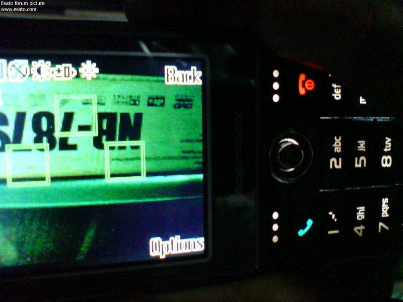

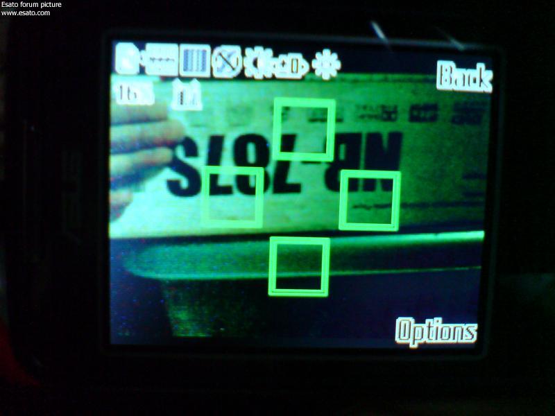

@genus
is this the purple fringing you are talking about in color saturation?!
Document Mode: Flash ON: (Lowlight indoor)
i have used your 4.4 driver in shooting this.
and about the focus matrix; here is a sample from ASUS V80 phone
comes with 2MP auto focus feature. (notice the green squares)
now, this can be adjusted to 3 or a single center focus.
[ This Message was edited by: rockygali on 2007-11-13 04:45 ]
