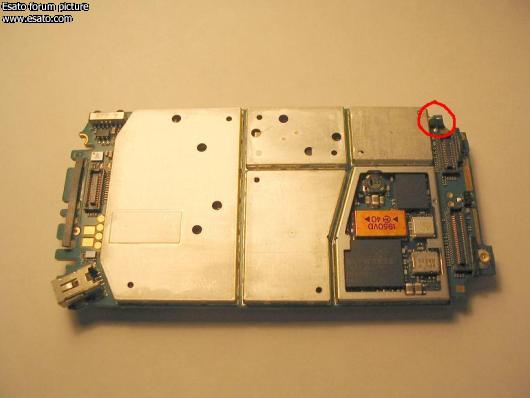

after i changed full housing for my phone , it does not work . When i turn power on , the screen Appear the text SONY ERICSSON , and after that , the screen turn off (black screen , no light) but the small screen outside still work , look like my phone alway close , the small lcd screen outside alway on . Everybody help !!!! help me how to fix it , pls ( 420 usd )
campbellnz Joined: Jun 30, 2005 Posts: 14 From: Auckland, New Zealand PM |
There is a little magnetic sensor inside your phone on the main circuit board in the top left corner. If the sensor detects a magnet it turns of your main screen and turns on the external one. Some phone covers have a magnet that causes the sensor to think the phone is closed thus the main screen gets turned off. Hope this helps. |
kennybanh Joined: Aug 20, 2005 Posts: 5 From: USA PM |
thanks a lot ! i will try . |
dont know how to fix , do u have a picture to show me how to do , thankx so much. |

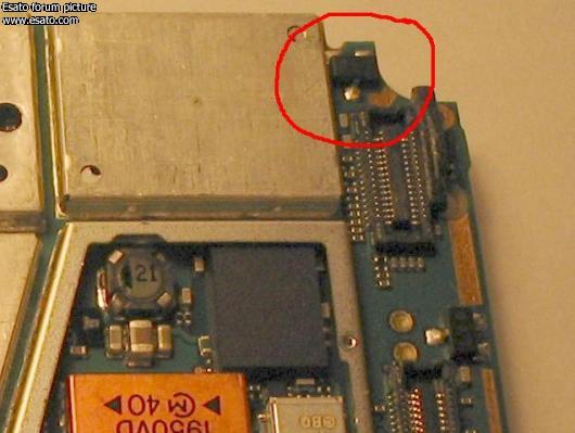

Do you have a phone cover on your phone? If so remove it to see if that was causing the problem. If not then remove the housing from the top section of your phone. There is a little magnet inside the housing just to the left of the 1.3 Megapixel sticker that interacts with the sensor on the lower part of the phone so it can tell when the phone is closed and turn on the external screen.
Power up your phone when you have removed the housing from the top section to see if the main screen is now working as it should. If this does not fix it then you may have a faulty sensor that thinks a magnet is present and turns off the main screen.
On a phone that is working correctly you can get a small fridge magnet and pass it over the area to the left of the left hinge and the main screen will turn off. It could be that the magnet in your new housing is too strong. Here is a picture showing the sensor.
already remove the housing , but did not see the part u shown .
If the part is not there now does it look as if it has ever been there?
no , didnt have that part . Maybe i lost it . How can i fix now ?
ps : Thanks for ur reply . |
If it has snapped off then you will have to send it to a service centre. If it was never there then your phone might have a different set up from my V802SE. Can see why your phone would be different from mine though. Are the 2 solder points there where the sensor should be? Maybe you could post a picture of your phone here so I can see what is wrong. |
