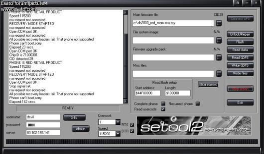

puerrican85 Joined: May 27, 2005 Posts: 28 PM |
Heres a pic of the setool window
u should be able to make out most of whjat it says.
Esato reduced the size |
gbrooks3 Joined: Jun 02, 2003 Posts: > 500 From: OTP RED CID36 PM, WWW
Strange, all looks good. Have you any antivirus? Firewall? Power managment activated? If so turn it all off.
