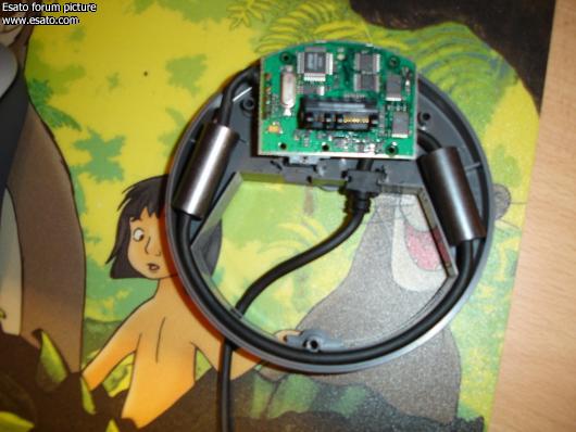

Pay attention when disassembling, because it took me longer to reassemble then to do the dirty, cus i couldn't remember how the "weights" were positioned.

@vijay555 here's I pic I took to help me put it back together!
