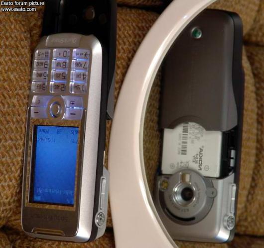

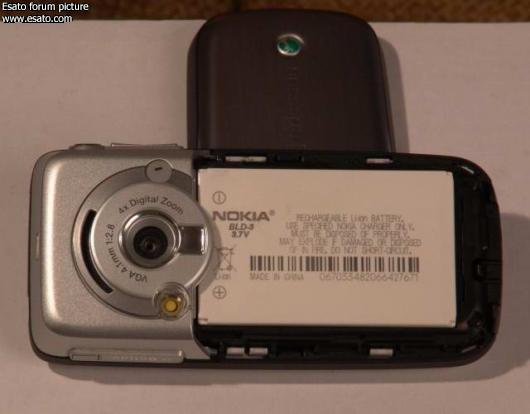

How about using the Nokia BLD-3 battery in the K700i?!
In another forum I visit, one member (thanks bien2) suggested this and it seems to work for his phone. Quote "With light usage, batt life is about 4 days before the batt indicator goes red, that is still about 1/3 of the way full."
bien2, if you are reading this, I hope you don't mind me using your pics here....

I have a BLD-3 Nokia battery. I'd like to try that but I noticed that the terminals on the battery and the on the phone do not line up. |

Yes it works with my sister's 3200 battery, and even says Optimised Charging when I put it on to charge. |

I tried it with N3200 BLD-3 battery and it didnīt work...

i tried my brothers n8310 BLB-2 and it fits and the phone turns on and works normalluy, even says optimzed charging, but its not slim enoug h to fit the back cover of the SE back on. |

BLD-3 worked for me, and the cover fited too, but....is this safe??? anyone tryed for a long time??? how many days in tlak time and stand-by??
