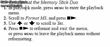

wslinda Joined: Nov 13, 2004 Posts: 1 PM |
When formatting my MS with HBM-30, it appears "Format MS no" message on the screen??
Why?? Would anyone can advise me how to format with the equipment? |
Gaijinsan Joined: Jun 21, 2004 Posts: 34 PM |
@wslinda
I took this from the handbook the only other way is to format it using software that comes with sonys memory card readers.

generic Joined: Jan 12, 2005 Posts: 2 PM |
The "no" at the end is a sort of "Select menu". Press the up or down arrow on the device, and it will say "Format MS yes" instead. Then press the Play button to format.
